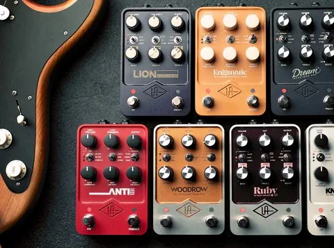

支持 UAFX 2.0 的效果器
请通过 UA Connect 更新你的效果器固件,以获取新的脚踏开关模式(音箱类效果器)、更新后的蓝牙功能、有线控制和 USB MIDI 控制功能。
ANTI 1992 High Gain Amp
Dream ‘65 Reverb Amp
Enigmatic ‘82 Overdrive Special Amp
Knuckles ‘92Rev F Dual Rec Amplifier
Lion ‘68 Super Lead Amp
Ruby ‘63 Top Boost Amplifier
Woodrow ‘55 Instrument Amplifier
OX Stomp
Golden Reverberator
Starlight Echo Station
Astra Modulation Machine
Del-Verb Ambience Companion
Galaxy ‘74 Tape Echo & Reverb
Max Preamp & Dual Compressor
